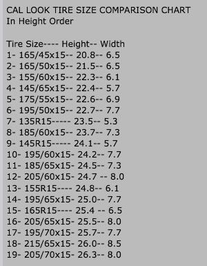

I located a pair of 3.5" width Bogart front wheels. I was considering installing my current 145R15 Nankang tires. Can anyone comment on using that size of tire on a narrow wheel, or perhaps an alternative tire size?
This is for a street/strip Beetle...but those 3.5" wheels would be primarily for the drag strip.

Okay, so I've mounted the 3.5" Bogarts with my old 145R15 Nankang tires and it's not too bad, however, on a full-circle turn, the tires are just rubbing on the fenders a bit. Murz: thanks for the list above, I'll do some measuring to determine some suitable smaller tires. Here's a photo of the wheels:

I just picked up a set of 145x65x15s for my 3.5 ercos. They'll be mounted this next week. I anticipate awesomeness. Front runner look, useable width, oh and speed rated.
