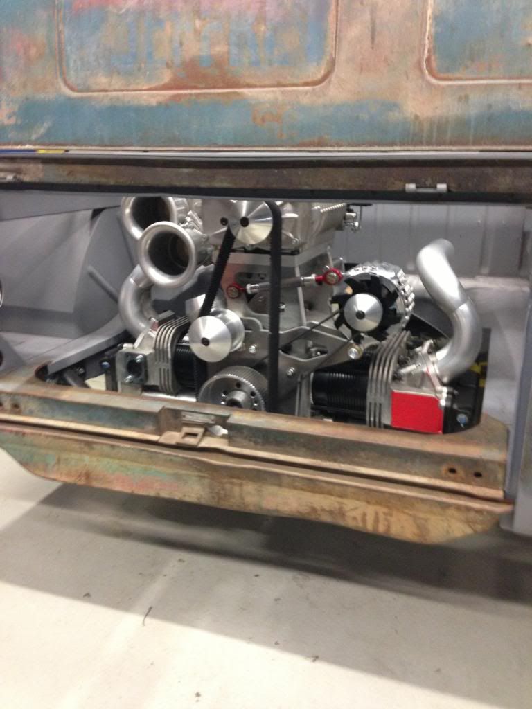

Have been reading with interest for a while and this is my first post.
I am currently building a "steetable" Single cab that I plan to drag race.
Grover is a 1954 Barndoor single cab that I have had for a while now and like all things is getting out of hand :happy:
The engine is an Autocraft 101.6 x 88. It runs a moldex crank, Pauter rods, CP pistons, 910 heads with Titanium and Incanel valves etc. The trans is a bus box build by Dave Butler (Dangerous Dave) to be as strong as it can and will run A RLR rev 6 clutch.
It will be super charged with a 2300 Harrop charger, with a water to air inter cooler. A Haltec ecu will control the fuel and ignition and full data acquisition.
The SC will be full bodied and has an ANDRA approved roll cage.
I am not sure how all this will work so I am hoping my questions can be answered here.
Thanks
Phil

the twin intake throttle bodies look like a Nitro Harley set up. Very cool builf but to do it to a barndoor and not a later SC is hard to take. Keep it up it look like a killer idea nonetheless! :th_DragRacer:
Re: Grover
I understand your concern about it being a barndoor, and when I am finished it still will be a barndoor.
Simply with all the work done to the body, even with all the mods I am leaving it in a far better condition than when I bought it. So I see it as preserving the SC, as most of the new metal has been installed with a fanatical approach to authenticity.
All the stock running gear has been cleaned and stored, if a concourse style restoration was planned in the future.
The throttle bodies are Jenvey and I fabricated the intake with aluminium mandrel bends and laser cut flanges.
Phil

Insane!! Love the twin intake setup.
