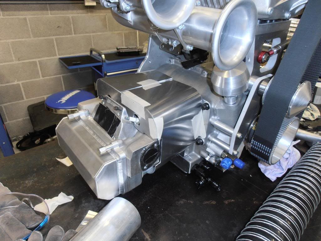

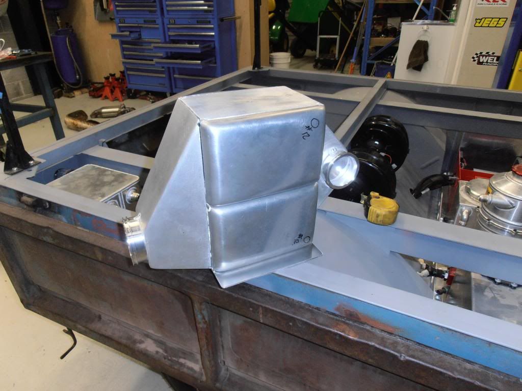

Starting to get somewhere.

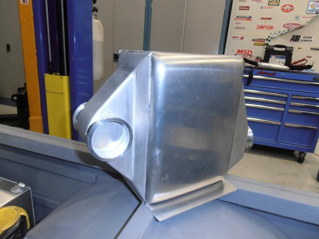

The inter cooler all mocked up for a trial fit and to work out all the plumbing.

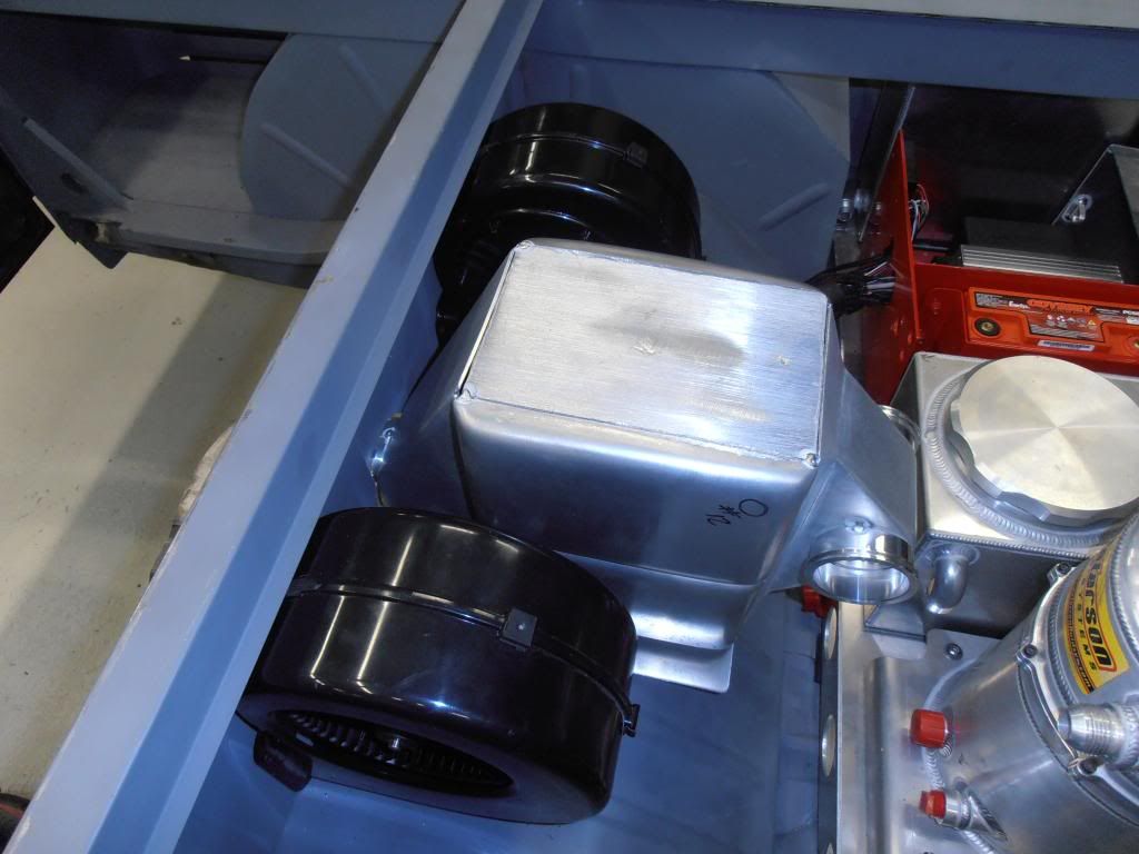

Cooling fans mounted
Cooling shrouds coming together.
Phil

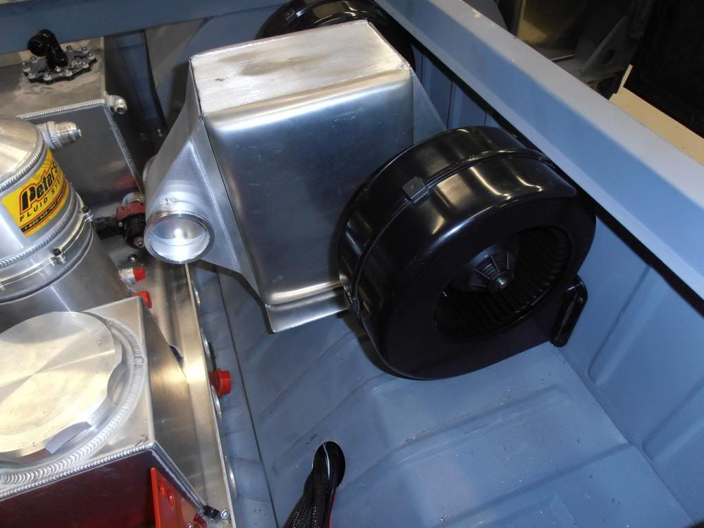

I spent way too much time on the cooling shrouds, but they are 99% done.
All welds are Shauns http://www.shaunscustomalloy.com.au/index.php

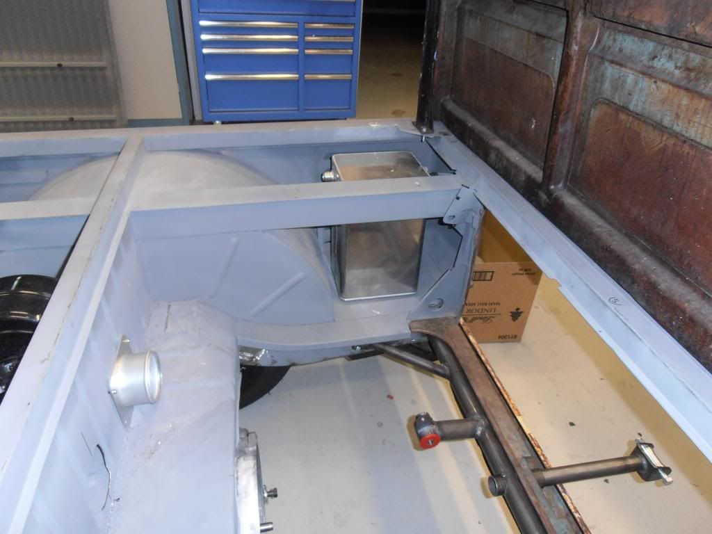

Welded tab on for Oil filter, I am not sure I will need it, but have the parachute anchor sorted, its removable.
Nice Big Catch can/ breather.

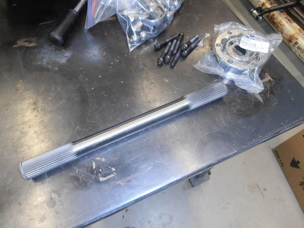

Just arrived, 300m axles from Kartech, thank good the size is right :thumbsup:
Phil

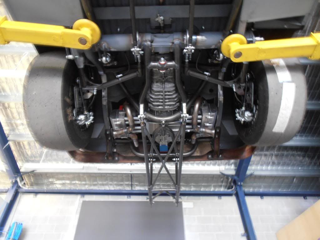

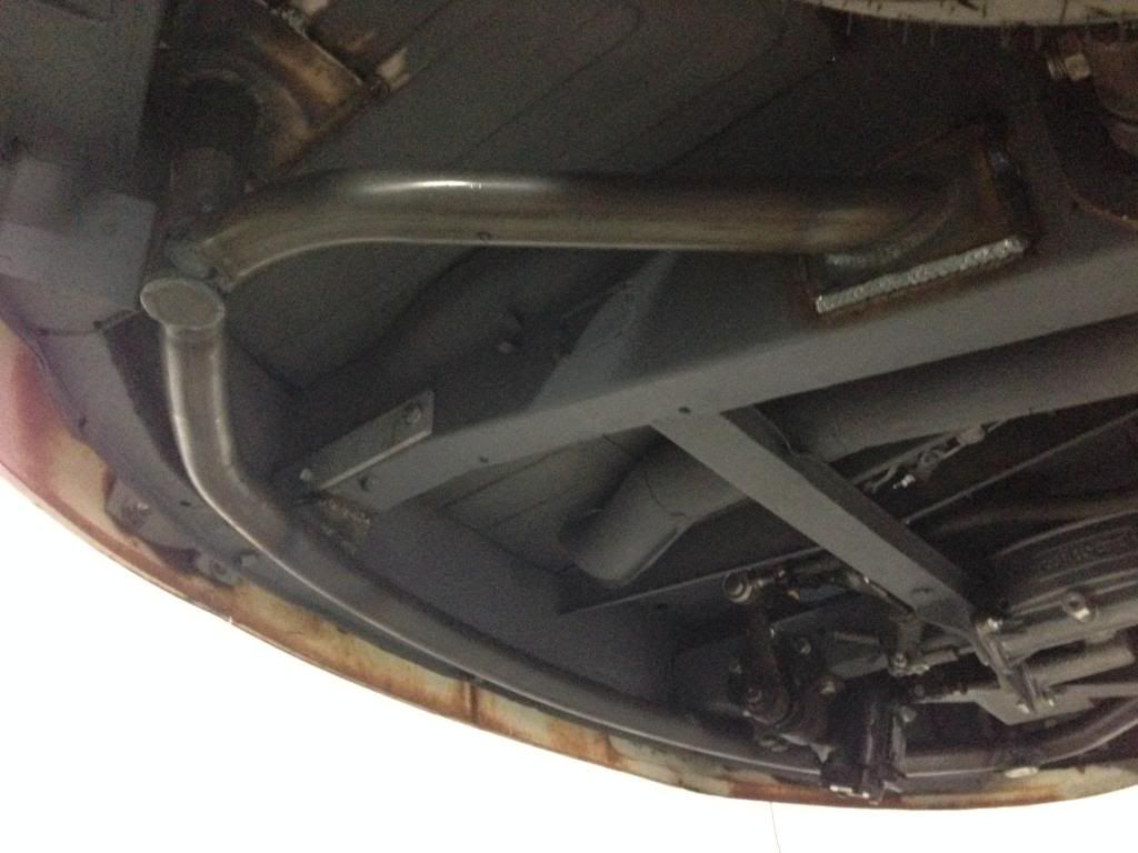

Drawn a line in the sand to have Grover running down the strip at The Sydney VW Drags in Feb.
Finalizing a few things before his underside get a paint.

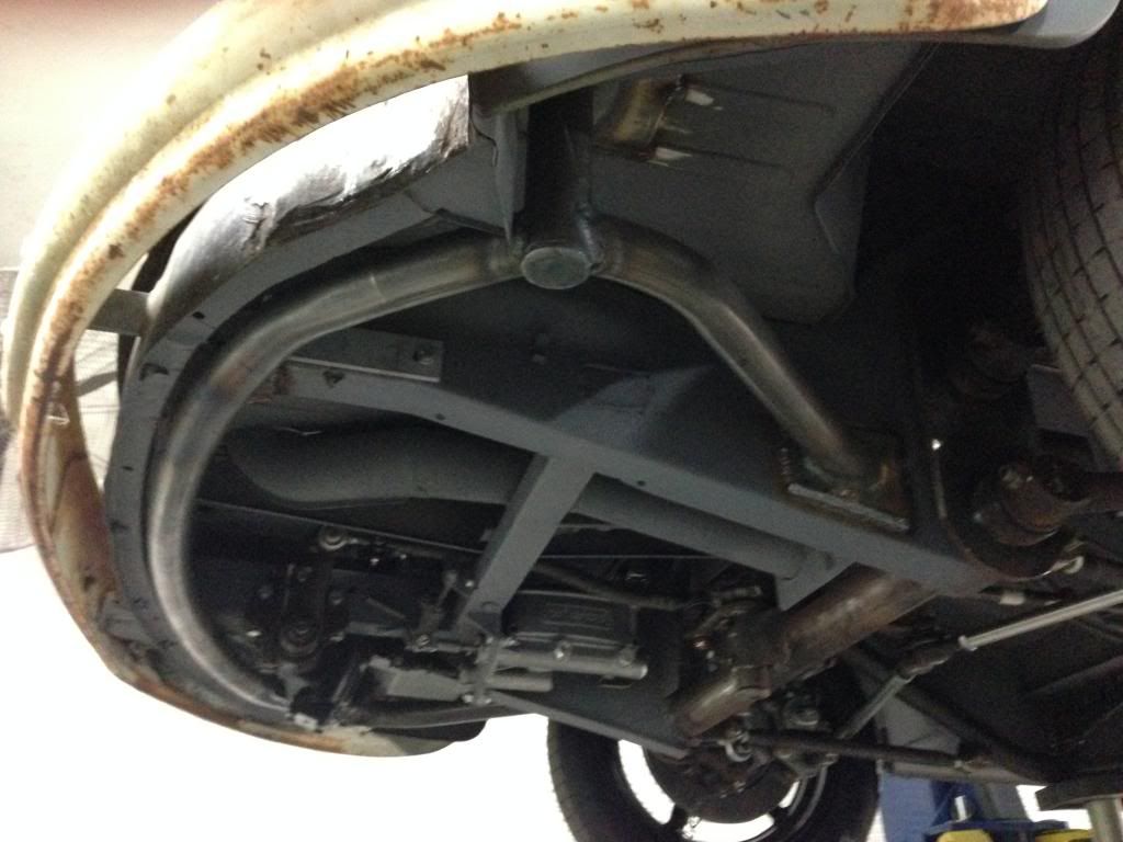

Added another tube the front, really happy how it turned out, probably not a bad option for streeters, you cannot see it when its on the ground.
Phil
Very nice upgrade there.... BD's are not the strongest of Bus'. so any improvement along those lines must be a good thing.

HI Grover,
Thanks for your compliments, but again its not all my work, I only dream of welding like that.

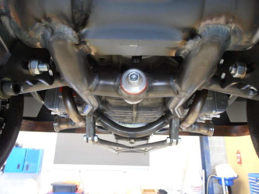

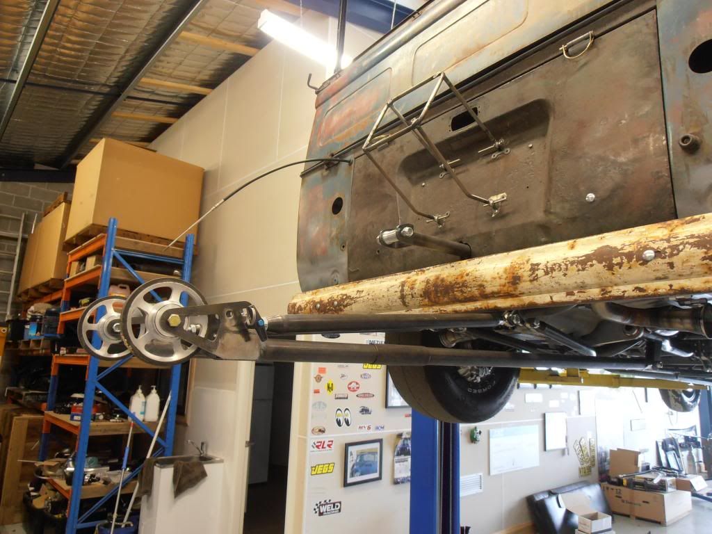

Paul and Cain from Pro flow did their magic and fabbed up the wheelie bars and some more bracing.
Off to paint this week.
Phil

Gotta love a Type 2 with wheelie bars...
Better yet a T2 with a parachute mount....... :happy:
