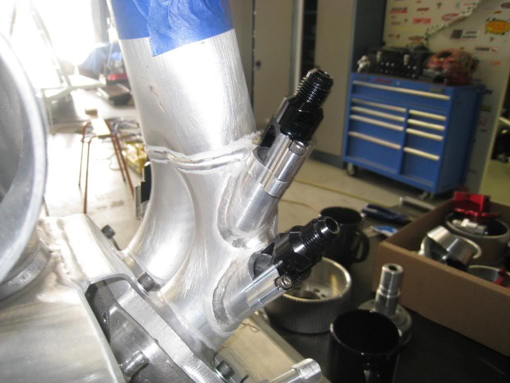

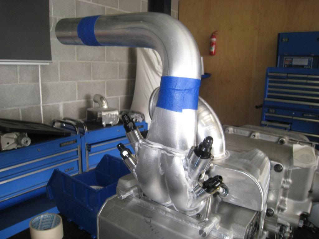

The final nagging project was the intake.
What a mission:
I drew up and cut the flanges and mocked up the runners, Dave Stoker machined the injector pockets and holders, Owen CNC milled them to slim them down so they fit and the brilliance of Shaun from Shauns custom alloy made it all work with his incredible welding and fab skills.
