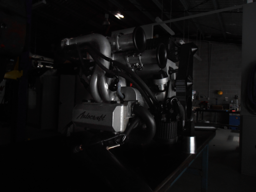

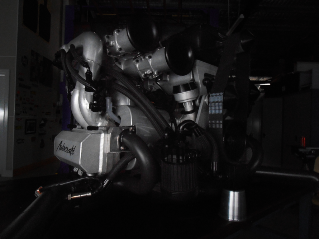

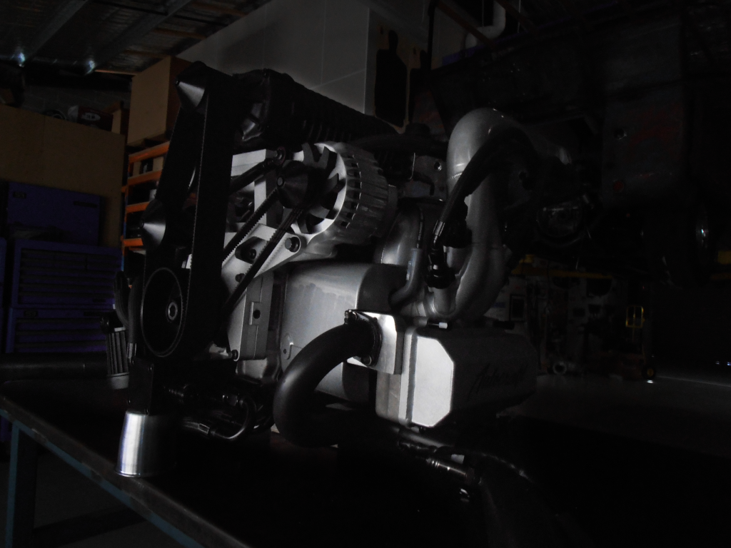

Some final pics of engine before it went back in last night.
Love the new detailing there Phil... Top job mate.
That engine is artwork, one of the top 5 best looking engines ever
