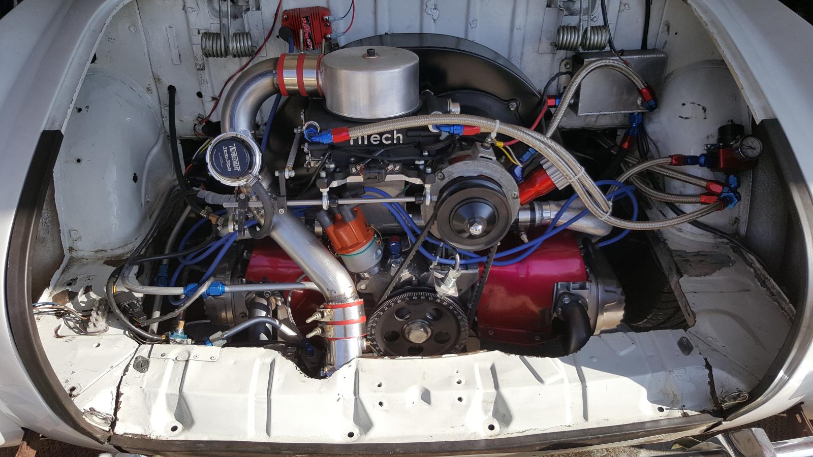

Here is a picture of the engine -- finished -- for now -- this week -- today
Have made some templates to cover all the openings around the engine, but need to get some sheet metal to finish.... I've got some stainless sheet laying around but other than my 4" grinder, I really don't have a way of cutting it.
