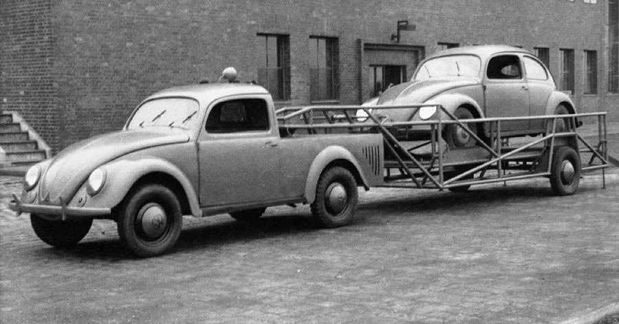

Some may prefer the off road look....circa 1946
Re: Mr Duncan, your next model....
[img= width=800 height=418]http://i65.photobucket.com/albums/h226/Mag001776/1946factorybugtruck.jpg[/img] factory? gooseneck cal look hauler?
Might have to build another one like that for a tow car-needs to be lowered with some 17 inch Fuchs
I don't know the details of this combo, but if it was a factory effort(as it it appears to be) right after the war, used to transport various vehicles from a to b around the Wolfsburg facillities,...We could call it a "Hirst shifter"...
I will agree with that... :thumbsup:
Mike
The car on the trailer looks to have the 4 wheel drive front hub,not a normal hubcap.Is this what I am seeing?
That is possible..Also,looks like something MAY be near the area nomally reservered for a bumper... could be a roller nose...Or it could be a winch on the carrier...

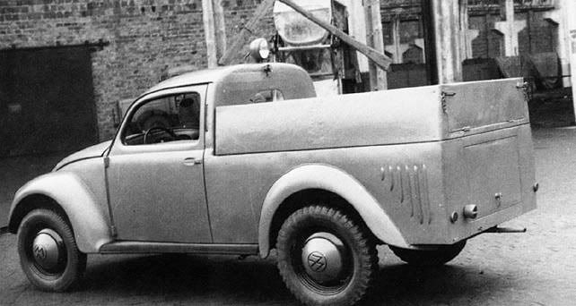

I had a look through my Volkswagen Military Vehicle books of the Third Reich-and it appears the car on the trailer is a Type 87 4 wheel drive Command Car without the standard military off road tyres(which used all the Schwimmwagen mechanicals),and the ute is a modified Type 92 rear wheel drive,with the Kubelwagen suspension(basically the same stuff that ended up in the Buses) There was also a Type 98 4 wheel drive sedan,but was a Cabrio version(open roof). Where did you find the pic? I haven't seen it in any of my books.
